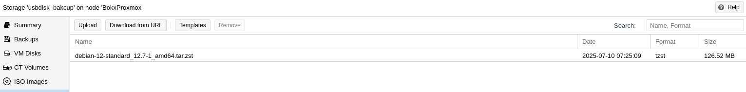

On the disk after the run:
Can I download the template and place it there myself?
I find the template and downloaded it…
Indeed now the script runs without error!
Thank you!

Try run pveam update and then download the template.
