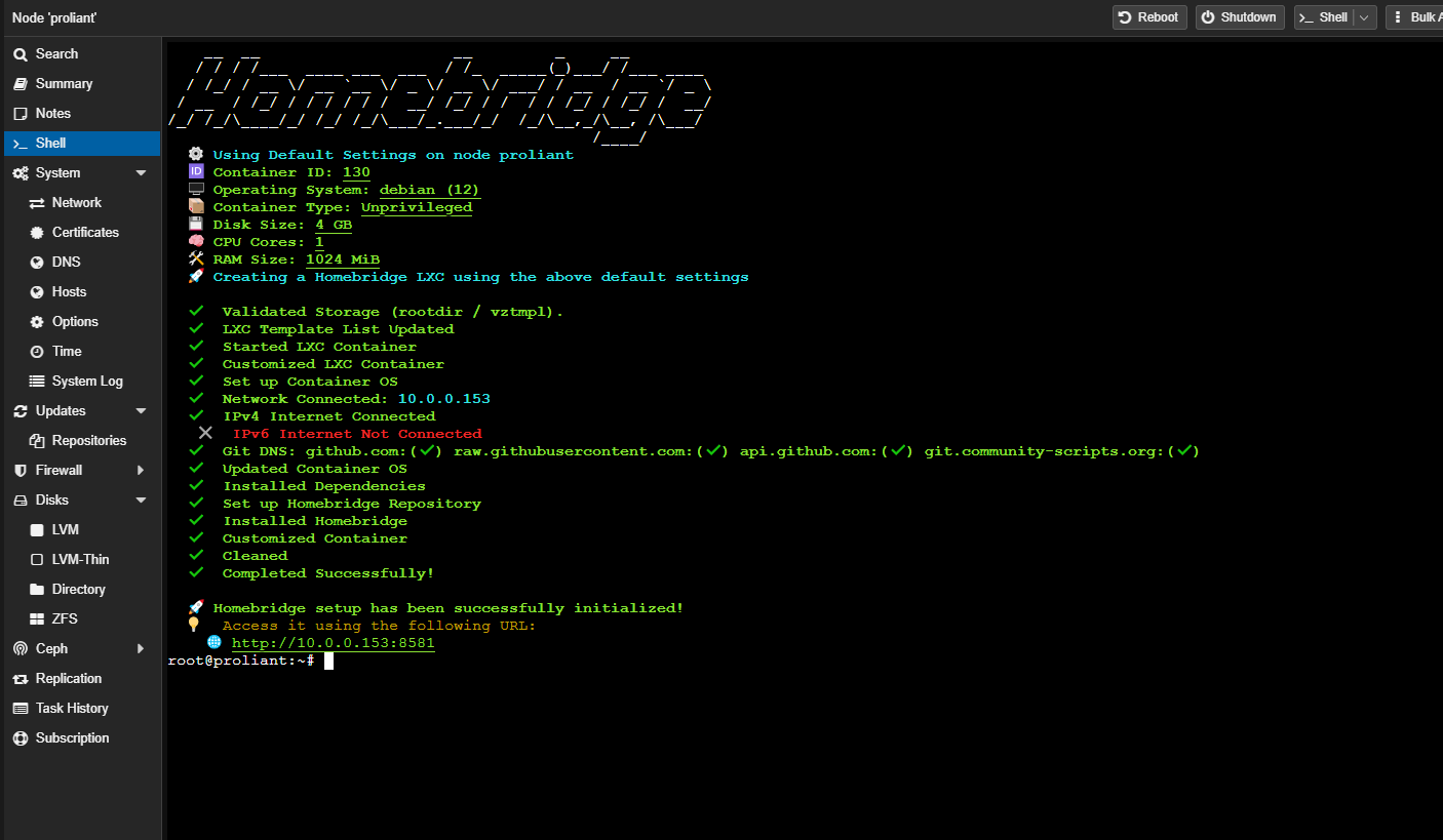

To create a new Proxmox VE Homebridge LXC, run the command below in the Proxmox VE Shell.¨
bash -c "$(wget -qLO - https://github.com/community-scripts/ProxmoxVE/raw/main/ct/homebridge.sh)"
Default Settings: 1GB RAM - 4GB Storage - 1vCPU
Homebridge Interface: IP:8581
Location of config file: /var/lib/homebridge/config.json
