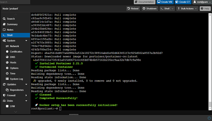

To create a new Proxmox VE Docker LXC, run the command below in the Proxmox VE Shell.
bash -c "$(wget -qLO - https://github.com/community-scripts/ProxmoxVE/raw/main/ct/docker.sh)"
Default Settings: 2GB RAM - 4GB Storage - 2vCPU
As an alternative option, you can use Alpine Linux and the Docker package to create a Docker LXC container with faster creation time and minimal system resource usage.
To create a new Proxmox VE Alpine-Docker LXC, run the command below in the Proxmox VE Shell.
bash -c "$(wget -qO - https://github.com/community-scripts/ProxmoxVE/raw/main/ct/alpine-docker.sh)"
Default Settings: 1GB RAM - 2GB Storage - 1vCPU
